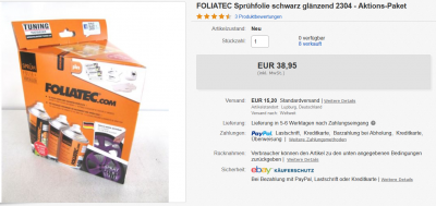

Odločil sem se, da bom moje zmahane srebrne zimske gelge počrnil.
Logični nakup bi bil plastidip (3x) + glossifier (1x), kar bi naneslo dobrih 60€ s poštnino.
Po prebranih forumih (predvsem tujih) sem se odločil za nakup Foliatec.
Ni tekoča guma, ampak tekoča folija, predvsem je bolj glossy.
Na Foliatec.de je kar draga poštnina (sum. cca 70€), tako da sem nabavil na ebayu (54€).
There is no comparison, and I have used plastidip previously.
Foliatec may seem more but add up the pricing to get plastidip to give you a gloss finish and its the same price or more and Foliatec will still have a better finish.
Coverage per can is more with Foliatec as well, I did my wifes mini Cooper S all 4 wheels with one can and thats 4 coats per wheel.
Plastidip is a rubber spray compared to Foliatec with is a film hence them being able to get the smoother finish and gloss straight out the can with no spraying additional glossifier etc.
Plastidip however you can mix any colour you want, not so with Foliatec only the caliper paints you can mix a desired colour but thats permenant

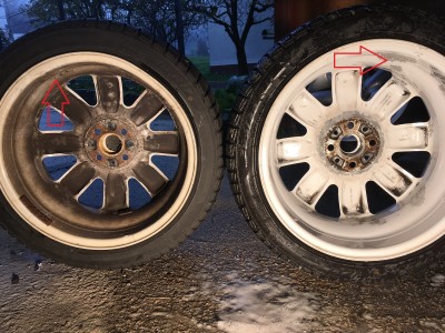

Danes sem se lotil čiščenja felten... in sem opazil, da so čisto zje*ane.
V glavnem, čiščenje 1h/feltno... šprical še nisem.
Že danes pa zadevo pripročam kot zaščito novejših, kot pa reševanje starih.
Bomo videli kakšen bo končni rezultat.

A ni levo platisce na sliki malo jajcasto?
tomzzi
Prispevkov: 2117
Pridružen: Pe mar 11, 2005 9:47 pm
Re: Plastidip ali Foliatec
Napisal/-a tomzzi Če nov 01, 2018 10:33 pm
Ne malo. Meni se zdi kar fejst jajčasto.

Jajčavost bom še preveril (in dal ravnati), ampak slika je le slika =P
