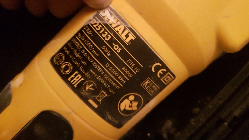

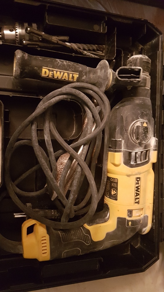

Napisal/-a motom Ne feb 25, 2018 10:58 am
