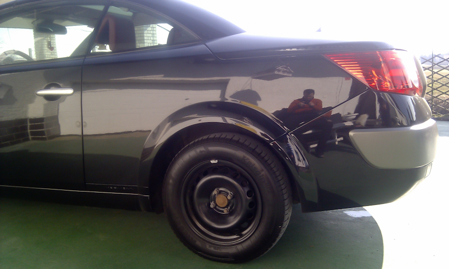

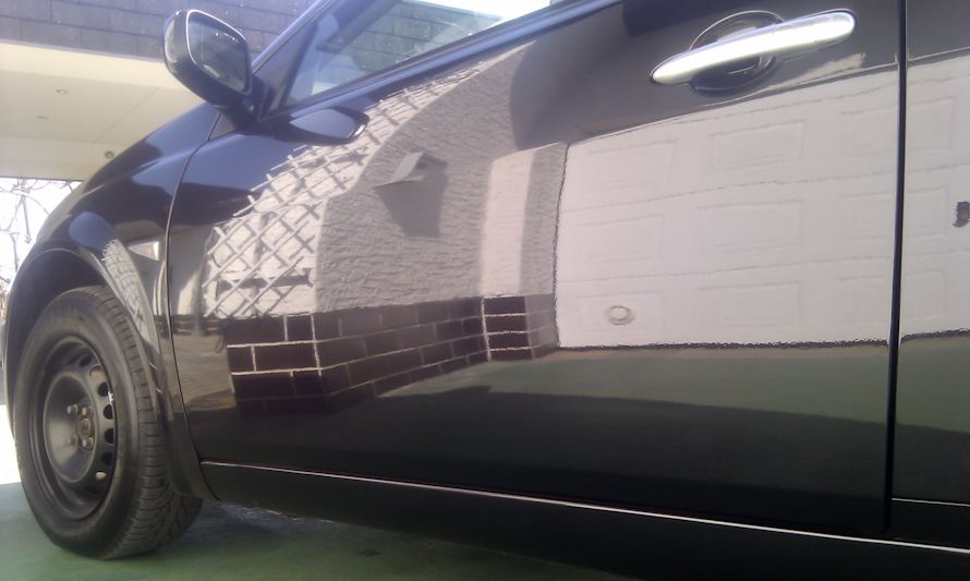

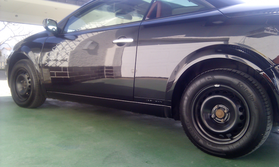

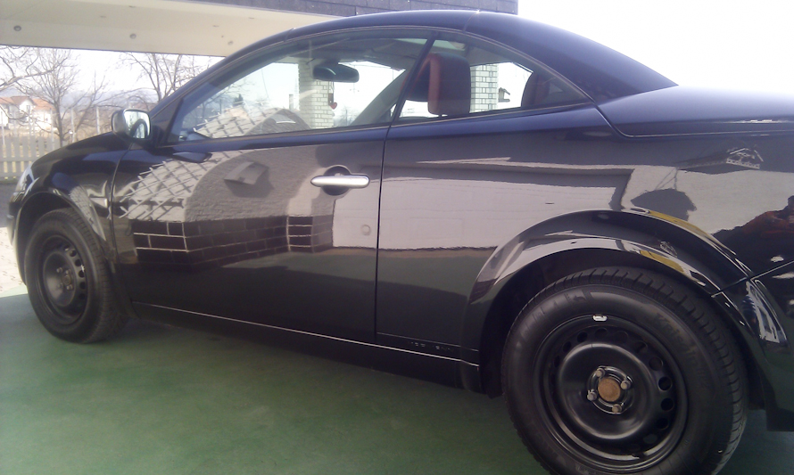

Napisal/-a jure1981 Sr apr 13, 2011 5:52 pm
and there was reflection :twisted: .... se opravicujem zaradi kvalitete fotk.. slikano s telefonom..
