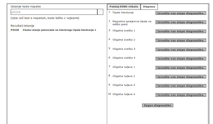

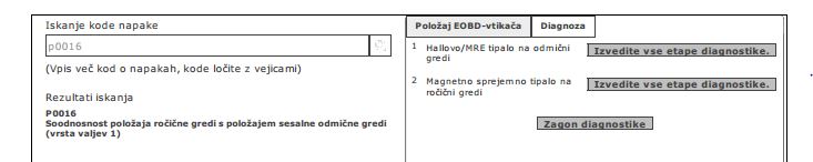

Napisal/-a hermand So mar 24, 2018 9:16 am
