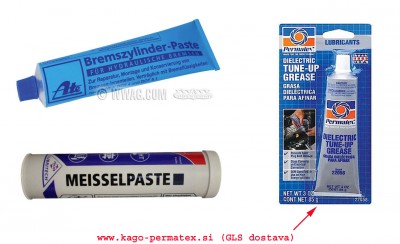

Napisal/-a Nikola_Tesla Sr mar 16, 2016 7:58 pm
Pa lepo sčistiti in ustrezno podmazati.
