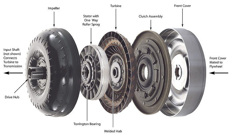

Očitno res gre za obrabo sklopke:
Q: So what usually fail on the torque converter?
A: Usually, the failure point is the lockup clutch. It has friction material, which is designed to wear out, but they also last a long time...

Ja govorimo o sklopki pretvornika navora.
https://www.youtube.com/watch?v=hhwYIs6Lu3M
Prikazuje... ko je tlak olja dovolj velik sklopka zagrabi.
