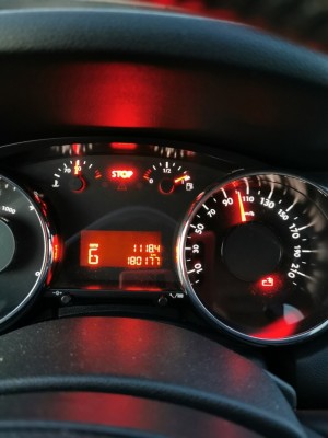

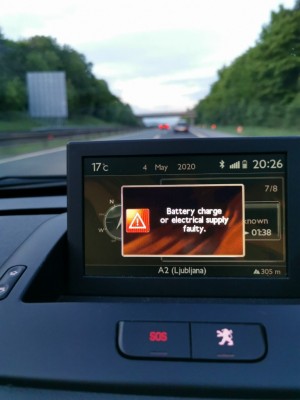

Pozdravljeni,
zanima me ali se je komu ze kdaj pojavila napaka
battry charge or electrical supply faulty. Ker na zacetku sem mislil da je kriv akumulator pa sem ga zamenjal zdaj mi pa obcasno javlja napako battry charge or electrical supply faulty. Pa sem peljal avto na pooblasceni servis pa so mi rekli da je racunalnik za vzdrzevanje napetosti potem sem sel se k drugemu pooblascencu so rekli da to ni mogoce itd.
Zanima me ali kdo pozna kaksnega mojstra k bi znal to odpraviti ker da vozim sem pa tja pa da mi potem vsi veselo menjajo rezervne dele...
Hvala vsem za pomoč

Če je volan električni: Preverite ali zaklepanje volana deluje pravilno/brezhibno. Ko se da kontakt, se meri padec toka.

Kaj maš to mild hibrida ali kako?
V kolikor imaš garancijo pazi da je ne izgubiš če pelješ avto h "majstru"

Peugeot 5008 je letnik 2013 1.6 hdi
Edino kar sem opazil je, da ko je zunaj mrzlo mi začne javljati na vsakih 5 minut, vcasih pa gori celo pot.

Kje imaš to?
The parameters can be read to determine the accuracy of the BCSU using Diagbox to determine if there is a problem - there is nothing you can physically do to check this. In the event of it failing, the BSI assumes control of energy management regardless and ignores the BCSU values.
A battery discharge is more prevalent in the winter months anyway - with more electrical consumption equipment being used, short journeys, not allowing the battery to get a good charge, more power needed to start the engine, poor earth connections, battery at end of service life (anything over 5 years on an X7), alternator not charging for example.
First thing is to see if the alternator is charging or not and if it is, then suspect the battery or its connections.
Tudi kabel za ozemlitev je lahko :DDD
My 307 cc had the same issue, I picked up a 680cca battery half price on a eurocarparts sale and used some spare heavy gauge cable left over from an amplifier installation to upgrade the ground points from the battery to the alternator and to the chassis of the car, it's been fine since
Meni je na Škodi pa krmilna enota za ventrilatorje klimo, praznila aku in ventilatroji so se vrteli še 4 minute po vožnji + vklopili so se že pri vžigu vozila :roll: Ob menjavi modula sem videl , da je bil že popravljan in samo zalepljen skupaj :twisted: :roll: itak je lepilo popustilo pa vlago not spustilo :!: Kos za 40€ so šli lepiti :lol: :evil:
