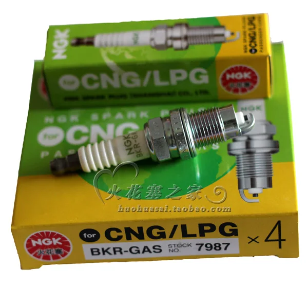

Prvič pa vidim svečke celo za CNG/LPG :roll:
https://cartreatments.com/copper-vs-iri ... ark-plugs/
