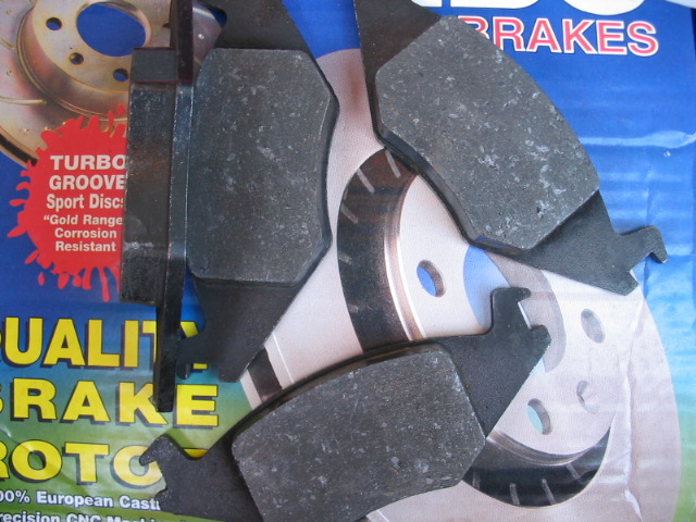

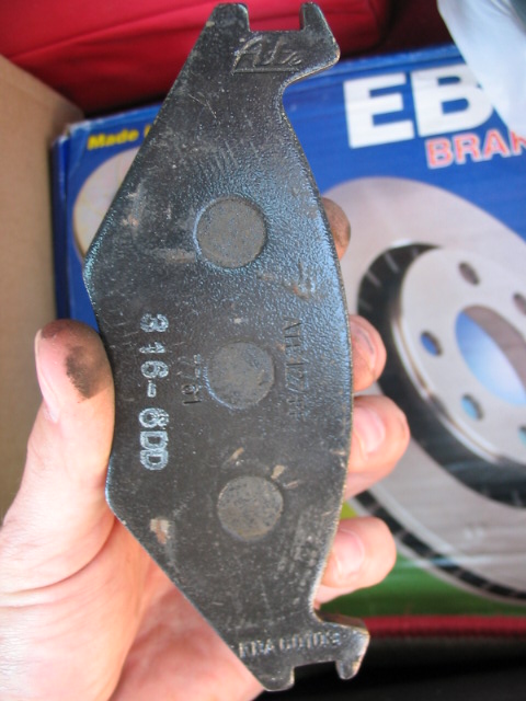

Fullback
Prispevkov: 1736
Napisal/-a Fullback To avg 16, 2005 8:30 pm
evo teli mislim da so za golfa 2...ATE firma
dam pocen
