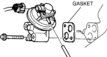

Avto mu spušča dimno zaveso, kak malo bol pohodiš plin. Nekje sem bral da je med krivci za to EGR ventil. Sicer ga je fotru pred časom serviser kao "spuco". Pol je bilo nekaj časa mir, zaj pa spet spušča zaveso. Filtri in olje je menjano.
A ve kdo mogoče kak spucat - spihat ta EGR ventil, oz kaj je še lahko vzrok za dimno zaveso

Mah..kaj se tulk sekiraš kak boš EGR spucu...vrž ga dol pa ga blindiri,pa je..Sej ga itak ne rabiš....sam je pa vprašanje če je krivec za dimno zaveso sploh EGR....

@napi: Glede pihanja na prvo šajbo....obstajajo navodila za uporabo vozila ;) Tist je za hitro odroševanje oz. odmrzovanje prednje šajbe.Zato se klima uklop...neki čist normalnega. Glede dimljenja...tak kot sem reku...EGR dol pa ga blindiri.

Kaj pa je sploh AGR ventil in čemu služi :?:
Mad
Prispevkov: 2828
Napisal/-a Mad Pe jan 12, 2007 9:02 pm
Maxx je napisal/-a:Kaj pa je sploh AGR ventil in čemu služi :?:
EGR : Definition: The EGR valve is the main emissions control component in the exhaust gas recirculation system. The valve is located on the intake manifold, and opens a small passageway between the exhaust and intake manifold to allow a metered amount of exhaust to flow back into the engine. This reduces combustion temperatures and helps control the formation of oxides of nitrogen. The EGR valve is opened by the application of vacuum to its control diaphragm. Some also require a certain amount of exhaust back pressure before they'll open. On newer vehicles, the valve is electronic and uses one or more solenoids or a small stepper motor. The valve should remain closed while the engine is cold and at idle. It should only open once the engine has warmed up and is running at part-throttle. If the valve sticks shut (or is disconnected), NOX emissions will soar and detonation will often result (See Detonation and Spark Knock). If it sticks in the open position or fails to close all the way, it acts like a vacuum leak resulting in a rough idle, hesitation and possible stalling.

Hvala za odgovor,kaj pa je narobe če to blindiraš oz.a je sploh kaj razen da ti sesalne ne zamaže
TrijoAdijo
Prispevkov: 4168
Napisal/-a TrijoAdijo Pe jan 12, 2007 9:48 pm
Ja narobe je edino to da škoduješ okolju. :D
Aja...predn se spravte zadevo blin dirat,priporočam en test: Pajt na AC pa ga zgon malo v obrate...pa tak naredi ene 20km.Če bo nehu kadit, bo ok...če pa ne pa blindiri EGR.
