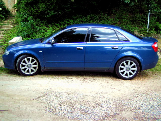

MALO ZA POPESTRITEV - MOJ A4, MALO TRUDA, POTUJEM PROTI S-LINE.
LETNIK 02, 96 KW, 1.9 TDI.

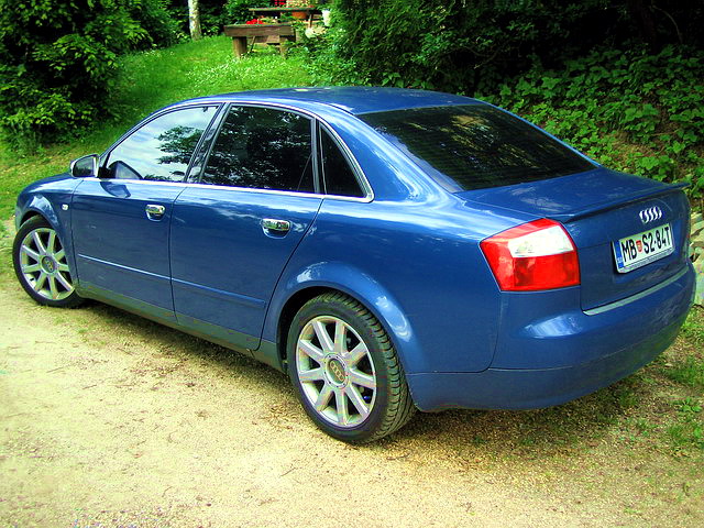

ŠE ENA
No money, no funny...

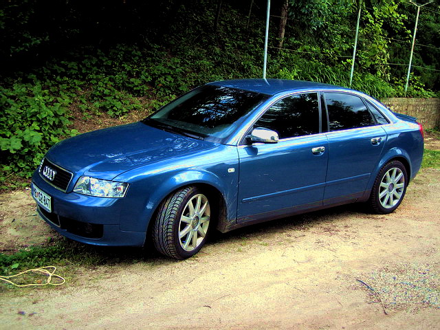

IN ŠE ENA...

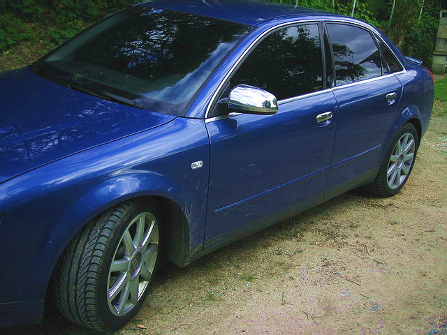

MALO TRUDA TU IN TAM...

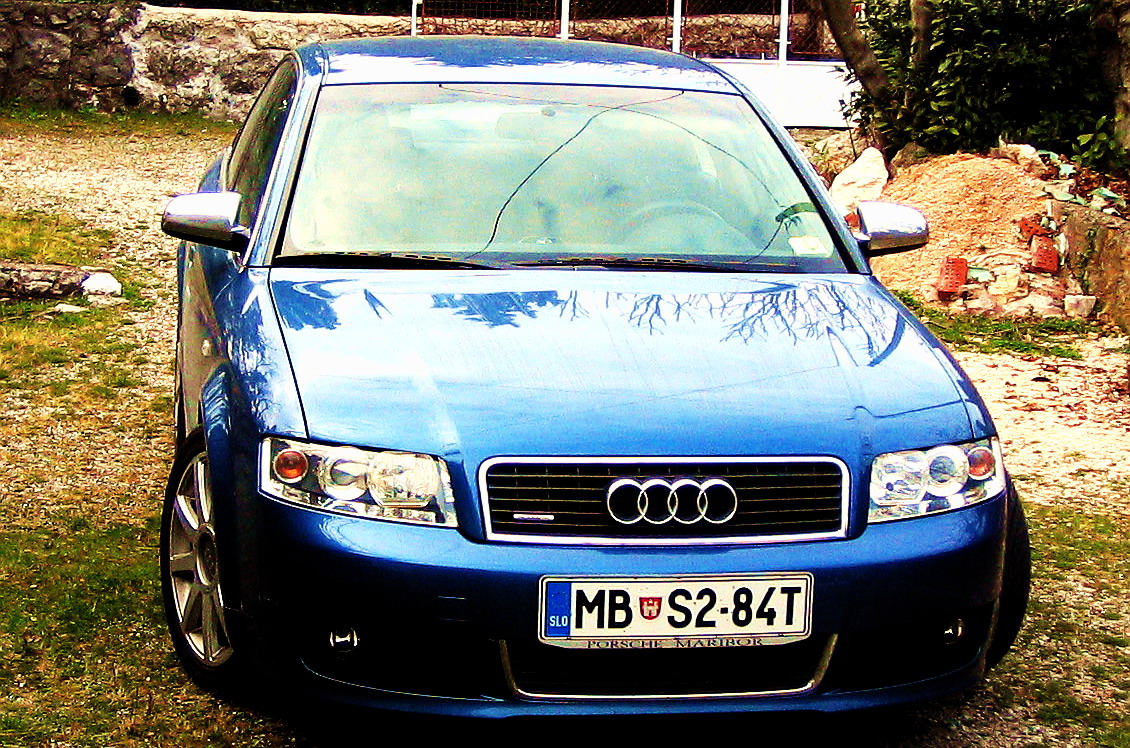

IN ŠE RITKA--:
