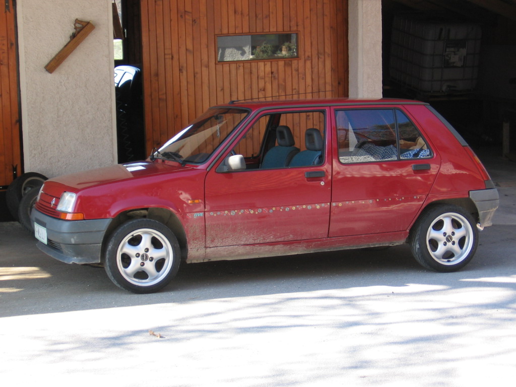

Napisal/-a gashper Po feb 12, 2007 6:23 pm
kmau update :D
[url=http://www.poraba.com/car_details.php?carid=27793] [img]http://www.poraba.com/povprecna/27793_2.png[/img][/url]
gashper
Prispevkov: 381
Pridružen: Ne dec 03, 2006 2:23 pm
Kraj: Gorenjska
Napisal/-a gashper Ne mar 11, 2007 11:10 am
ewo. 15' feltne so ze gooooR :D ampak sam za probo :(
