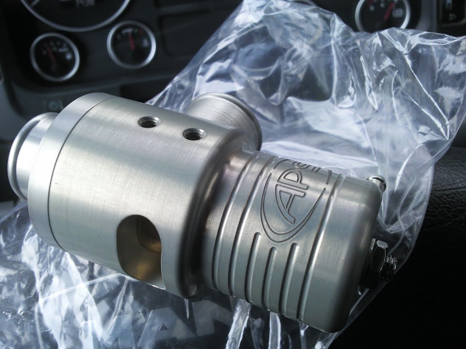

lahko predstavim še en bov.....ki mi ga je priporočil loco. Gre se za APS dual bov blow off.
1. Ports Closed - Under open throttle conditions where turbocharger boost pressure is required, the bronze BOV piston is held shut in order to supply the maximum amount of charge air to the engine
2. Primary Port Open - Under light load conditions where the throttle opening has been reduced or shut, the piston moves partially up the bore travel and opens the primary port to vent charge air back into the inlet tract. This ensures smooth engine operation and alleviates the rich condition and subsequent backfire when utilizing a BOV construction that vents100% of charge air to atmosphere.
3. Both Ports Open - Under high load conditions where the throttle has been shut, the piston travels fully so that both the primary and the wide mouth secondary ports open to vent the maximum charge air possible. Air vented through the primary port is routed back into the inlet tract. In addition, additional excess charge is air vented through the wide mouth secondary port to atmosphere.
na Evotu se pri 1.4 boosta in 1.0 stalnega tlaka super obnese. Kako bo pri nekje 1.8 pa še sporočim
lp :D

kingroad je napisal/-a:lahko predstavim še en bov.....ki mi ga je priporočil loco. Gre se za APS dual bov blow off.
lp :D
Nič posebnega praktično klasičen blow off. So pa kvalitetni blow offi, v primerjavi z dobrimi membranskimi npr. APRov R1 so počasnejši (povzročajo boost spike) in jih je težje kontrolirati. Predvsem zaradi trenja med ohišjem, cilindrom in o-ringom. Kot vse cilindrske blow-offe jih je potrebno obdobno mazati za optimalno delovanje. Samo delovanje pa dosti niha glede na temperaturo. Slednje ni težava pri membranskih.
D.
Zakaj biti porno zvezda ne more biti vrlina?
kingroad
Prispevkov: 199
Pridružen: Če sep 18, 2003 2:48 pm
Napisal/-a kingroad Po dec 07, 2009 10:07 pm
Niso vsi cilindrični enaki. princip s cilindrom je res enak, vendar imajo različne režime delovanja. Eni so recicle, drugi so atmosferski in tretji "50/50" s tem da se delijo na koliko, kam in kdaj pihne zrak. Nekatere nastavljaš z menjavo vzmeti, druge z vijakom itd.
APS dual bov mi je predvsem všeč njegov režim delovanja. Ne zmede ECUja kot atmosferski a vseeno v visokem tlaku "kihne" in ni preveč glasen da ne zbudim sosede (no, Milltek jim že para ušesa :D )
Nisem se pa nikoli poglabljal v membranske bove tako da jih ne poznam.
