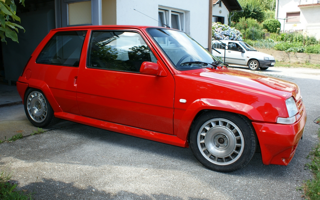

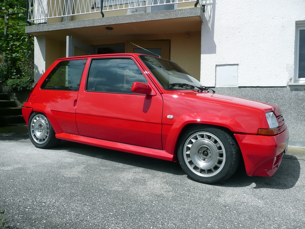

Napisal/-a FRIZUREVIC Sr avg 13, 2008 12:05 pm
ČAKALA JE NA APGREJT...PRŠLA ZDEJ Z BARVANJA!
PROJEKT JE STARTAL!
POVUCI, PA POTEGNI GA MALO!
