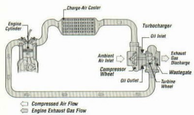

...Intercooler deluje tako - zrak - masa zraka, ki vstopa prihaja z nekim nadtlakom - zaradi srečanja z drugim medijem - vodo ali zrakom pri prehodu skozi intercooler izgubi temperaturo in plin se pri tem tudi zgosti in tako dobiš večjo maso zraka ... če ti daš intercooler na navaden motor tam ni tlačenja zato bo učinek nasproten zaradi uporov in padcev tlaka in cene intercoolerjev so še kar velike ... poskusi pa povej - moraš pa dat kar denarja ... jaz jih rabljene dobim po 500 ali 300 eur odvisno od velikosti - dobri so tisti iz aluminija recimo Cosworthov, ki stane nov 700 eur rabljene izpod 350 ne dobiš ... za 300 dobiš tamalega od sierre - tistega z vstopom 45 mm ta velik od 57 mm pa je 500 eur ... custom za Audi 1.8T je 900 eur S4 tudi 900 USD ... Exchanger Theory and Intercoolers

An intercooler is a heat exchanger. That means there are two or more fluids that don't physically touch each other but a transfer heat or energy takes place between them. Turbo Regals made in 1986/87, Turbo TAs, GMC Syclones and Typhoons all came with intercoolers to cool down the hot compressed air coming from the turbocharger. Turbo Regals and Turbo TAs use outside air as the cooling media; Syclones and Typhoons use water. Turbo Regals made in 1985 and before did not have intercoolers as original equipment.
At wide open throttle and full boost the hot compressed air coming from a turbocharger is probably between 250 and 350 deg F depending on the particular turbo, boost pressure, outside air temperature, etc.. We want to cool it down, which reduces its volume so we can pack more air molecules into the cylinders and reduce the engine's likelihood of detonation.
How does an intercooler work? Hot air from the turbo flows through tubes inside the intercooler. The turbo air transfers heat to the tubes, warming the tubes and cooling the turbo air. Outside air (or water) passes over the tubes and between fins that are attached to the tubes. Heat is transferred from the hot tubes and fins to the cool outside air. This heats the outside air while cooling the tubes. This is how the turbo air is cooled down. Heat goes from the turbo air to the tubes to the outside air.
