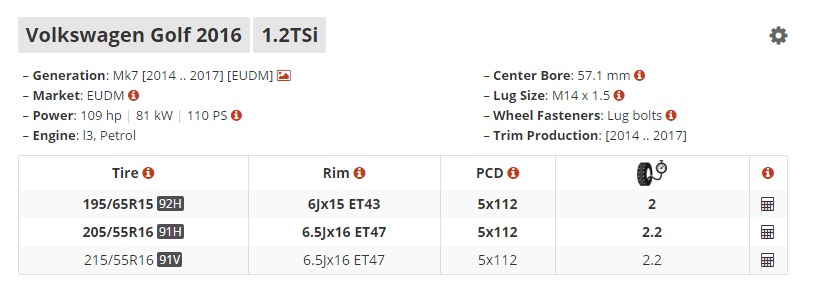

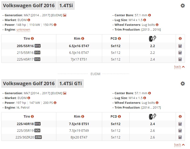

Napisal/-a Ivan36 To sep 20, 2016 8:57 am
Še slike . :roll:
Volkswagen Golf 2016   Wheel   Tire Sizes  PCD  Offset and Rims specs   Wheel Size.com.jpeg

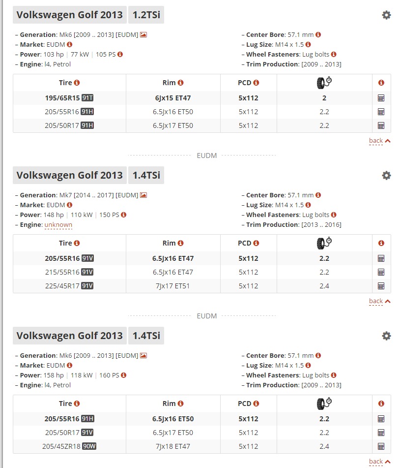

Napisal/-a Ivan36 To sep 20, 2016 9:19 am
Pa še G6
