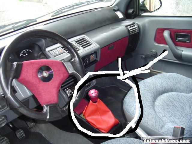

zanima me kako nej prerihtam menjalnik, kr ma rikverc na dvig...če kdo ve prosm če svetuje ...hvalaa :D

kako mislš...a če hočm menjat uno bunko pa manšeto morm ceu menjalnk menjat?

Dej povej prosim še enkrat kaj bi rad naredil? :ue

Napisal/-a nero9 Po feb 13, 2006 12:05 am
to

Rikverc na dvig :?: Kaj te s tem misliš? :roll: Da moraš obroček gor potegnit, če ga hočeš vzvratno prestavit; al da moraš ročko ven spipat? Če se gre samo za obroček, mu pač spodaj vzmet odstraniš in ga gor prilepiš.

sebaveh je napisal/-a:Rikverc na dvig :?: Kaj te s tem misliš? :roll: Da moraš obroček gor potegnit, če ga hočeš vzvratno prestavit; al da moraš ročko ven spipat? Če se gre samo za obroček, mu pač spodaj vzmet odstraniš in ga gor prilepiš.
ja da morm obroček dvignt da dam vzratno....kva če kj zjebem tist fedr al pa kj...jao to zakomlpicirano :D :D :D :D

google je našel:
right its the same on all the clio's. the new shape and the old mark 1's. all phases. ive just dont it to mine to put on a new momo gear knob. you first have to cut over the top and sides of the old gear knob and use a screwdriver to pry it apart. itll then split and com eoff in two bits leaving behind a white looking mould that the gear knob was on to stop it twisting or coming off. you have to do the same with this and cut over the top and down the sides then split it off with a screwdriver (or chisel). that leaves the gear shaft which is knurled on the top and shouldnt require you to use any of the grommits that come with the gear knob as its a wide shaft. hope this helps as it just took me about twenty minutes to do and isnt hard.
http://www.google.com/search?hs=Nhm&hl= ... skanje&lr=
Raje še malo okoli poglej kaj je še kdo drug napial.

Moraš dobit prav tako "bunkico" k je spodaj širša in je narejena za avte ,k imajo za prestavit rikverc "na dvig"
